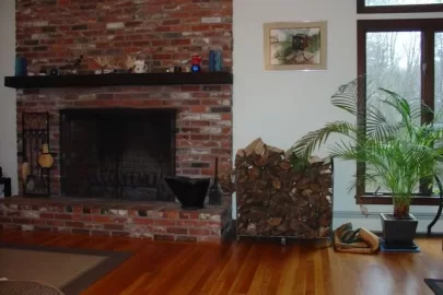

Okay, so I just can't stand to look at my fireplace. It is an inefficient beast. My latest idea is to hearth mount a Hearthstone Shelburne. I originally ruled out this idea due to my mantel clearance. However, this has always been my favorite stove as I think it looks solid in matte black, has a 2 cu. ft. firebox, takes 20" splits, is designed like a battleship, and is built in Vermont. So, I e-mailed Hearthstone and inquired about the mantel clearance (which is not printed in their manual btw). They sent me an addendum which allows a 28" clearance. So, I will still require a mantel shield, but I can easily meet all of the clearances.
Does anyone have any input on this stove? I am comparing it with a Jotul F 400.

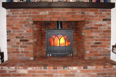

What about an F 600? I may have the opportunity to pick up one of these used for a great price. Is there such a thing as too big of a stove? It will fit and I can work around the clearances with a mantel shield.
There is a such thing as too big of a stove. How far into the fireplace will you be able to stick it? Too far in would make the side load feature wasted. I like oversizing stoves for my own use, but I run them hot , open the windows and doors which ends up wasting wood. I wouldnt go larger than the F500 for your size home, based on what I know so far
Yeah due to the depth of my fireplace, the side load door on the F500 & 600 wouldn't be very usable.

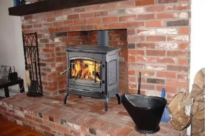

I think I have it narrowed down between the Jotul F 400 Castine and the Hearthstone Shelburne. They both fit fairly well, they seem sized about right, and I can pick them up for the same price. How do I decide between these two? What are the pros and cons of each? I want to buy a well built stove that will last for a long time.

I just bought a Jotul Castine F 400. Jotul has made a name for itself in making the finest cast iron stoves out there. I wanted a cast iron stove, so Jotul was my choice. I also decided to go with this stove because of my local dealer. The guy was extremely knowledgable and helped me plan out the install. He also helped me compare different sizes of stoves (not all from Jotul) so that I could see what would fit best. He basically gave me as much information as I needed and then let me make the decision. It also helped that two of the guys who work there own F 400's. They could speak from personal experience as to the stove's capabilities. One had the flat black and one had the blue black. I went with the flat black because that color goes best with the decor in my house. I have a fair amount of black furniture and black wrought iron. The blue black had too much of a gray tint for my likes.
I also like the size of the firebox of the Jotul which measured about 20.5" x 13.5" x 11" or roughly 1.75 cu. ft. Perfect.
I'll return with pics once I complete the install and start smoking out the house.
They both look pretty nice cropped in there. I would suggest getting the one that lets you bring it furthest out of the fireplace, if rear venting is possible for you (and maybe it won't be without a hearth extension).
EDIT - I posted a moment to late. Correction: I would get a Jotul!
Yeah I don't think I can go wrong with the Jotul. It is a tiny bit smaller than the Shelburne, but for my needs this is plenty of stove. It also fits and looks a bit better on my hearth. I have to go with a straight shot top vent. This will make cleaning a bit more difficult, but I should get a better draft. I clean my chimney myself anyway and it is a very straightforward 15' chimney with full access.
