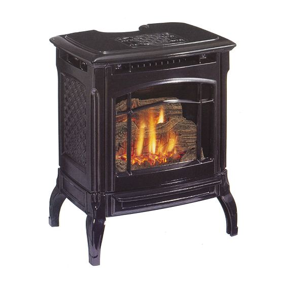

Long time since I've been on here friends ! Gf bought a cabin in Gaelton, PA. It has a like new Hearthstone Stowe DX Gas vented stove in it that was never hooked up there. It looks like it was run at one time. It says, 2013 but it looks newer. There is NG there and it looks like it was never switched to propane. I ran all brand new gas lines to it. I tried to start it sat. and the pilot would light but that is it. The pilot eventually would go out, That was using the remote ! I tried it in the manual On mode and the fan would run and pilot lit but it would not light the logs either ! I bled the lines again and tried it all again and the same things happened ! It had no excess gas or unsafe conditions ! Does anyone on here know what I should check next ? ? The screen on the gas connection is spotless, looks like it was never hooked up ! I installed all brand new DuraVent pipe horiz. thru a wall thimble to high wind cap. Thanks for any help ! ! Nickname, Quick

I got it going somewhat guys ! ! I ordered a new Pilot Burner assembly from Gas Control Parts USA ! They had the exact part for my stove ! I had it working last night. It takes about 20 attempts to get the main burner to stay lit ! It finally stayed lit and I adjusted the flame with the Air Shutter. The cabin was nice and toasty. I shut it off over night just to be safe ! It needs some adjustments but it is so much closer to working ! Anyone know what else I should try ? ? There is a pretty good HVAC guy in town that I want to get here to see what he thinks ? He will be able to check the gas pressure and adjust that if needed ? thanks !

Got it woking great guys ! We are snowed in with 12 inches of snow, So I had plenty of time to work on it ! Lights right up now and got the fan and the speeds figured out also ! Thanks to bigealta and DAKSY for the help ! Cabin is nice and toasty ! Hearthstone didn't give me one ounce of help ! ! Oh well !
