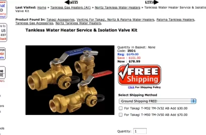

A nice clean way to do that is with tankless water heater valves. They combine a shut off, union, and purge cocks in one ssembly. Plenty brands and prices to chose from.
  • [Hearth.com] heat exchanger disconnects?
