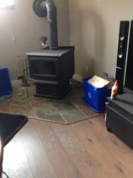

Hi all. This is not a stove specific question but maybe you can help me.
I have a Pacific Energy Summit stove in the basement. Room is 25 ft by 40ft. I would say it burns fine, good wood, flue thermometer reads between 300 and 500 F.
Here is the question. I have had 2 furnace guys into the house, I'm replacing the oil furnace with propane.
These guys look a the finished basement room, look a my stove and both said that stove is too big for this room. It must get really hot down here.
But it does not get really hot in the room. As a matter of fact if the outside temperature is below freezing outside, I cannot get the room above 20 C (or 70 F)
We have been at this house for 3 years now and this is consistent.
I think there is something wrong here, maybe it is the cold basement floor, always 13 degrees C.
Any thoughts?

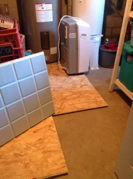

I have added pictures. The insulated sub floor is what i am going to put in the furnace room. When the furface is changed from oil to propane this spring.
Floating floors are pretty easy to take apart and put back together. If you are somewhat handy I would put some of that sub flooring under your floating floor.
