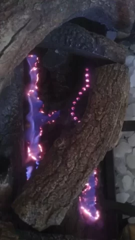

HELP I HAVE A 6000 SERIES IPI- T LOW FLAME I NEED A PIC OF THE ADJUSTMENT ON THE GAS VALVE LOOKING AT IT FROM UNDERNEATH I DONT SEE IT THERE IS A PLASTIC CAP I SEE BUT NOT SURE HOW TO REMOVE IT IF THATS IT I ATTACHED A PIC OF THE FIREPLACE AT HIGH FLAME AND A IF IT WAS WORKING FINE IS IT POSSABLE THAT I TURNED IT TO LOW FLAME 2 TIMES IN A ROW AND NOW ITS ON A LOWER SETTING PLEASE HELPS YOU AN SEE THE FLAME IS NOT ACCEPTABLE QUESTION WHY WOULD I HAVE TO ADJUST IT
  • [Hearth.com] Heat N Glo 6000 CL Low Flames
First of all, take your caps lock off. That's considered yelling in this forum (& most others). Second, use punctuation like you learned in English class so we can understand what you want to know. Third, what model 6000 do you have? There are many & they all have differences....
