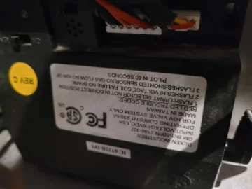

I just tried it again with glass on and off and does the same. pilot lights, then main fire lights and after a few seconds everything shuts off. The control shows 4 red flashes and one green flash after this happens. I reset the controls and it lights again, but only for a few seconds. It is a new pilot assembly so it should work fine. the gas pressure seems fine as well. I will take a video later and post it. this is the same thing that happened with the old pilot assembly. looking at the manual could be, faulty ground, low pressure, faulty pilot assembly. I don't think it is any of these.

do you mean the unit that the remote controls? it does light each time for around 10 seconds then shuts off. does the control, control the valve based on the flame/heat sensor?
