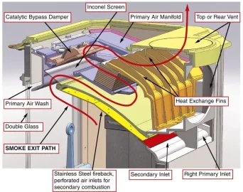

Woodstock Progress Hybrid Stove has the heat sink built in.

AH HA!!

In the woodstock stove, the heat exchanger improves the transfer of otherwise wasted heat up the stack. This is not the same as adding some form of mass to the exterior of your stove.
If you are looking at pulling more heat off of the stove (and there are cautions about that), you would be better off with lightweight fins to increase surface area. Its the same reason that radiators use fins, not blocks of steel.
