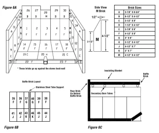

Have a Lennox Canyon ST310 ( a big stove!) Chimney sweep said my baffles were cracked probably because the firebox getting too hot. Replaced the baffles now I'm worried about the heat temp.
I have a thermometer inserted into the pipe and NEVER let it go over 800 F. Chimney Sweep said I should also have thermometer on top of firebox. Seems like over kill to me. Suggestions? Should I have a 2nd thermometer? If so, what temp? Thanks in advance!

I'm a bit confused, the Canyon used to have a firebrick baffle system. Did they change it to a baffle board? What year is this stove?

I haven't looked inside one for a long time, so I thought they always had this arrangement, but with some research I found that the 2009 manual shows firebrick, but the 2018 manual shows 4 baffle boards per unit. This may have been a change when IronStrike took over the brand in 2013.
Does the paint on the stove top show pronounced greying? If not, I suspect a baffle board was cracked by the other means. They can get cracked by hitting them with logs when loading and/or during sweeping if hit by the end of the brush. You could put a magnetic thermometer on the stove top, Condar makes stove top versions of their thermometers. Some people put it on the sloped face of the step top. Still, they way you are burning sounds good if peak flue temps are 800 or below. What temp does the flue thermometer show when the stove is cruising with the air turned down during the secondary burn?
