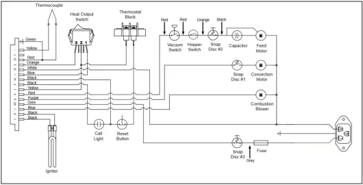

Hi all, first post. I seem to have an issue that is exactly opposite of what comes up whenever I search for answers. My auger won't turn off.
I have a PS50 and it's been fine for a handful of years now. At the end of last season my wife called me in from outside to tell me that the stove had a huge fire going. Sure enough it did, way bigger than normal, the entire firebox was full of flame. So we shut it down and let it die and I was going to check it out over the summer, but never did. Just today I went to get it ready for the upcoming season and cleaned it out (just a cursory clean, I know I need to do a deep clean) and turned it on to see if I could figure out why it had a problem at the end of the season.
Well, long story short, the auger does not turn off. It comes on from the moment the thermostat calls for heat and stays on. It will continue until the firepot is overflowing and just keep on going. Obviously if the pellets ignite it makes a huge fire, but with this much pellets being dumped into the firepot it has a hard time igniting and just smolders for a long while.
I've downloaded the service manual and done a fair amount of internet searching but everything is about the auger not coming on, nothing about it staying on. I'm guessing this is a control board issue, but I'm not even sure where to start checking.
Thanks for any advice you all may have.
