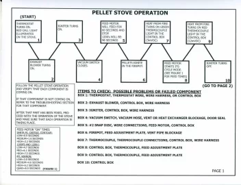

    The time will always be the same (each heat setting). Each heat setting, has a specified "On" time. The auger will be "On" for X seconds. This # only changes if you change heat setting. My Classic Bay is 6.1 seconds of "On" time. This will never change. The feed gate is an independent part that is purely manual and mechanical, and will not change this time either.
    The feed gate blocks the auger cover hole. The lower you put it, the less fuel. You must watch how low.you set it, as you may go to low, and the stove will not receive enough pellets for ignition on the next Call for Heat. If you run on High a ppt, its best to set the gate to where Heatilators recommend (4"-6" above pot on High).
    As for Low, if your heat loss is greater than the BTU output on the stove, then it wont get it done. The heat exchange system is about the only other thing thats different between a Quad and a Heatilator (Shell/exterior is the other). Quads have a far superior system to extract heat.
    As for you not being able to adjust the gate on low (unsustainable fire)? Have you tried a different pellet? Some pellets create a Much Larger Flame than other pellets? Thats why the feed gate is there, to adjust for pellet quality, keeping.the flame 4"-6" above the pot (on high).
    Here are some papers on a Quad, but same goes for your unit. Even the times should be about the same? My Classic Bay is rated at 47,500 BTU. Having the same controller, it should be very close to these #'s. Its a good troubleshooting guide.
