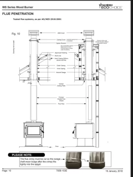

The stovepipe shield needs to go all the way up to the support box. The stovepipe is very hot up there.
In the US the clearance for shielded single-wall stove pipe is 6". What is the rear clearance for the stove with this install? The rear clearance for the WS22 is 7" with double-wall stove pipe.

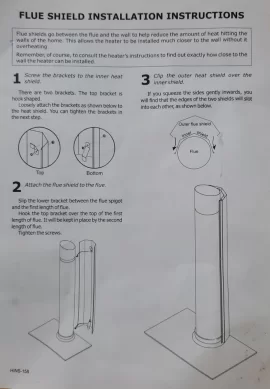

The shield is only designed to cover the first length of flue. I've never seen a full length shield over here.
It's also a double shield with an air gap between both shields.

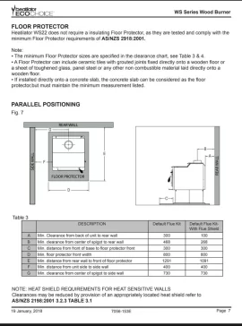

The manual stipulates 4" but mine is 5" from the wall.
Maybe clearances over here are more liberal?
25mm is 1".

The pipe must be shielded all the way up. Otherwise, the top portion of the single-wall pipe needs to be 18" from the wall. Is the 18" rule for single-wall not followed down under?
Interestingly, the US manual lists 7" for a double-wall stove pipe and 8.75" for single-wall, straight-up pipe.
However, looking at the Quadrafire 4300 step-top, I see the rear clearance listed is 3.75" for double-wall stove pipe or 4" if there is a 90º elbow above. This is one of the closest clearance stoves on the market.
I'm not sure, but it sounds like you may have bought a pair of shields. If so, one is supposed to go above the other, not layered on top of each other.
I'm absolutely certain it's installed correctly
I don't think any generic clearances exist here.

It has been compliance tested by an independent laboratory in this configuration, installed according to that configuration and the manufacturer's directions and inspected and passed by a building certifier.
I'm not sure sure how an unsafe installation would be recommended by all of the parties involved.
