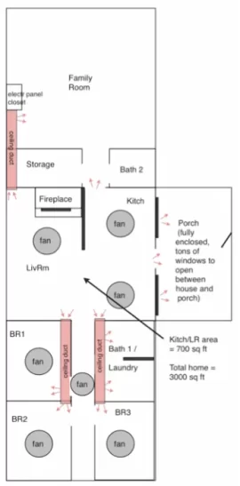

I purchased a long ranch home less than a year ago. It currently has electric baseboard heat in each room. It also has a masonry fireplace in the main living space in the center of the house, which we used some last year. I'm planning to put in an wood burning insert or a stove instead.
Which brings me to my issue. I would like to be able to use the woodstove to heat the entire house. Heating the main living space will be easy, but the rest of the long house is tough. I'm attaching an image here that's a rough layout of the house. In the drawing the fireplace is, obviously, where I'll be putting the new woodstove. The red ceiling ducts do not currently exist, but I would install them, possibly with an inline fan in each to encourage air flow.
See Attached Image

I should also mention... I realize the second bathroom won't heat. I'm ok with that. And, the house is moderately well insulated. It was built in '78, haven't noticed major drafts. I know the attic is insulated well.
It works better to blow cold air towards the stove room instead of blowing hot air away from it.
You might try putting what you have drawn in the floor instead of the ceiling and move cold air that way.
Fans will be needed.
I have a ranch and it's a little more open that yours and I use column fans without all the ductwork and it does well.

I don't think that you're in bad shape with the stove in the middle of the house like that! Install it and just turn on the ceiling fans in the livingroom, kitchen and hallways, keep the doors open, and see how she goes.
The family room looks to be the main challenge. It seems to be asking for it's own little heater. The bedroom area should heat ok with a fan on the floor at the far end of the hallway, blowing toward the stove area.
