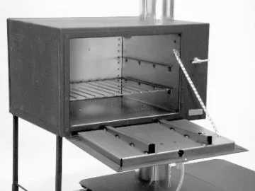

http://www.somomule.com/catalog/item/4600698/4650665.htm#image_1
$320 for the chimney oven. I think there is a catch though... I'm positive it is not UL listed. That may make it complicated to install and to get a building inspectors approval, even if it is safely installed (24" clearance from combustibles with 18" floor protector in all directions).
  • [Hearth.com] Heating and Cooking

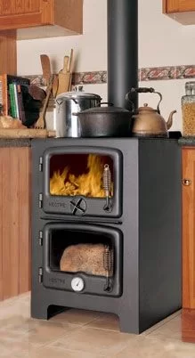

http://www.woodstoves.net/bakersoven2.htm Australian and fairly inexpensive. Made from steel plate, so not as attractice as the cast stoves.

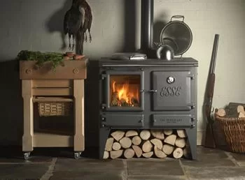

KeithO, that first stove is a beauty! Looks like a serious heater and cooker, oh, but what is the clearance of that stove, like 0"? wood underneath a butcherblock table next to it, and.. on the other side, oh that's just a rifle. haha, sweet rig.

JT, I believe they say 8" clearance to combustibles and 1" to protected (masonry) surfaces. If they have a refractory lining that keeps the outer surface of the stove cool while keeping the fire hot it may be true....
Thank you for the suggestion.... it is a beautiful stove but I think it is more stove than we need (and afford at the moment). Our primary need is to have a good heating system for the house and this type of stove may not be able to carry the heating load. An oven would be neat but may not be worth the sacrifice if it means we might need to supplement the heating of the house. I guess we are just trying to apply a type of permaculture thinking to the system in having multiple functions for home equipment. Just cooking on the top would be enough for now... at least until we become more educated. Thanks again.
