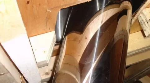

Some pics to show chimney below. 2nd pic is roof hole (contractor was a little sloppy here). 3rd and 4th are pipe through chase in 1st floor closet.

The clearances of the Class A in my house exceed the manufacturer's specs. I have a removable panel in the closet for the chase so I can inspect easily. While running the stove hot with a load of oak, I checked temperatures in the chase and in the attic all around the chimney with an IR thermometer. Everything was low. I sleep like a baby with the stove going.
You may have a good design, but if it isn't maintained and inspected, it will degrade. I deal with turbine engines that are a proven safe design, but fail due to lack of maintenance or other environmental factors.
My concerns for mine deal with how he cut the hole in the roof and sealed it, but I'll fix that up. Right after I inspect my chimney for the season...

From the pic it doent look like that stubbed off rafter is 2" from that pipe. Id say 1-1/4". Dont know why they didnt just pull that orphaned piece off the nails. Its of no use anyway.
I left mine exposed for a year so that I could check temps. No worries here either. Some houses are at greater risk from boiler pipes running through joists and floors than with a properly installed chimney.
Yeah - it's in the chase on the first floor that I was worried about and the clearances are exceeded there. The attic is cold and I've been up there when the stove is running full tilt. I can place my hands on the pipe there. That's about 25' above the stove.
Yes - I'm going to pull those stubs off and box that better. The contractor for the house failed to coordinate the center of the chase with the rafters. Duh.
Ummm...no. That's the local stuff for the chimney. Shouldn't have called it rafter. 90 psf roof.
