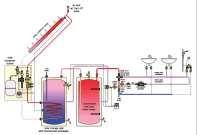

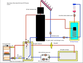

I use a fairly simple and inexpensive HydroniCAD from www.hydronicpros.com, they also have a symbol library for AutoCAD available. My system below in HydroniCAD
PowerCAD is another nice program but $$ all the i-dronic drawings are done with PowerCAD
