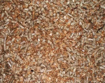

Actually, I did define the type of chips I was wondering about, chainsaw chips, uniform size and shape. I mixed a gallon of such chips into 2-3 gallons of pellets and it's having no effect on the auger. I'll go ahead and burn all the chips I have by mixing them in with the pellets. No problemo. I wonder what would happen if someone mowed their autumn leaves with a mulching mower and mixed them in with their pellets. Of course one would probably not be inspired to do that unless the price/availability of pellets was badly compromised. Hope things don't get that bad, but it would be interesting to know what would happen with such a test.
