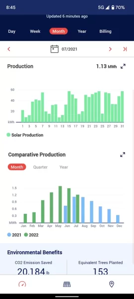

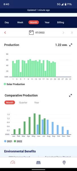

It's kind of sad that I pay almost as much in fees as you do for your base power!We have fixed rate here in MA. I pay about $0.17 pre kWh base + another $0.07 per kWh in fees on top of the $7 monthly customer fee and the "you own solar folk you" solar distribution fee for a total of about $0.24 per kWh.
We have an 11.8 kw system on our roof (32 x 370 watt panels) we purchased and had installed last June. We got to he 26% credit and our payback is about 6 years taking into account projected power cost increases. The first 12 months it made 11.375 MWh so we've been very happy with the performance. My house is 100% electric so it covers us fully from March through September. Biggest users are the AC, Washer/dryer, water heater and I have 2 kids so they are constantly in use. So far this year our statement is -$280 ish. We'll likely only have a bill in Jan/Feb.
It's really too bad most of the subsidies are going away or already gone. I absolutely love my system and am constantly telling anyone who will listen about the benefits of it. Between checking the solar app and looking out back at my wood stacks all I see is money in the bank!
How about the solar here this month? It's been insane. We could really use some rain but I'll take the solar $$$! My grass is brown but my electric credits are huge. In fact, we've already surpassed last July and it's only the 23rd.
Not wanting to get too far off topic here, but it has been a really wet and cloudy spring and early summer in my part of Oregon. This year so far is shaping up to be my worst year of solar production since I had the system installed.
The years can really vary for solar since we have so many rainy days here. The system meets about 90% of my electric needs, but if I was not heating with wood, I would be spending alot more on electric. On the plus side, all this rain in the spring made for a really great hay harvest.
