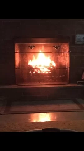

Bholler thanks for the concern, but I’ll continue doing what I have been for a long time. There were tons of fireplace made to burn coal back in the day. My chimney draft is strong even without a fire. I also have 3 CO detectors in my house. One in the outlet by the fireplace, one in the hallway above the fireplace, and one next to my bed. Burning wood also produces CO, as does any fuel when it’s burned. If your using anything other than electric you should have a co monitor. I attached an image of one of my typical coal fires

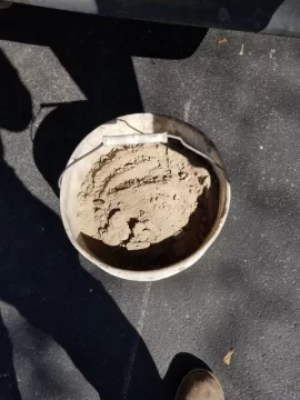

This came out of a chimney today with a keystoker running into it. Now to be fair half of that or about 2 gallons came out of the pipe. But the other half came out of 19 feet of chimney. And we clean it yearly. You can see that clearly is fly ash from anthracite.
