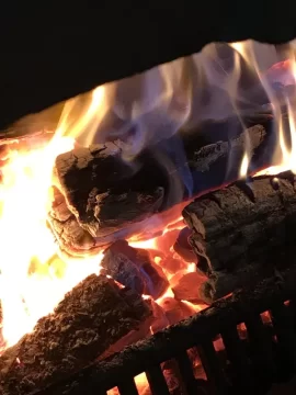

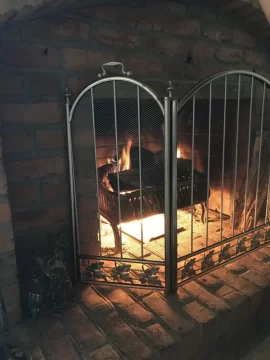

Update 2/8/20. Haven’t bought anything except some anthracite in the 40 pound bags. I got a used basket grate that really works well with anthracite if I open my clean out chute under the grate and open the clean out door outside downstairs. The darling wife is not on board with getting a coal burner but I still window shop. At least I get to enjoy the fire and maybe some day I’ll see one do cheap that it will follow me home. ;)
