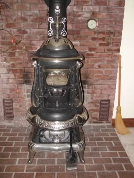

First let me start by saying my brand new brick chimney complete with a ridged 304 liner that is very well insulated has been completed !
And to boot I have finished restoring (kinda) My 1917 Florence Hot Blast #77 . She looks brand new. This year she got 2 new parts , A new fire bowl cast from the old one and a new cylinder skirt rolled from 16 gauge stainless 304 also. I am on my third day of burning it after it being dormant for many years.
My question from years ago, some times when the fire gets just right I get a burn in the fire that burns blue in color. is this gases burning real hot? What am I seeing?

blue is generally carbon based gasses burning away, sound like the stove is getting a whole lot of air. im not familiar with your unit (im old but not that old) does it have an "underneath" air control? if so you may want to close it down just a bit , when you get a lot of blue flames you are burning at a very high rate most times. slowing down underneath air if its there can ease that back a bit giving a longer burn with little loss of output as air will move through the stove a bit slower allowing for a higher transfer of heat before exhaust escape to the flue.
Thanks, here she is.. 93 years old . she been around 50 years even before I was born. If only she could talk..
