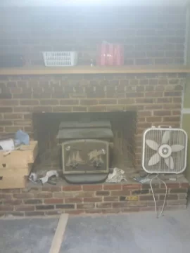

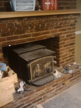

I am re-doing the downstairs portion of a split level 2000 sq ft house I recently purchased. The fireplace has a large opening and am wondering should I get a Wood stove insert or put a freestanding stove in the opening. I have went to 2 different dealers in my area and one says and insert and the other says "with that size of an opening you should just put a free standing wood stove in with a blower. Chimney is exterior masonry. dimensions are
front width 47 1/4''
back wall width 40''
height 29 1/2 ''
depth to flush of wall brick 23 1/2
Also the room this is in is 21 x16 right across from the fire place are 4 steps to a landing then 4 more steps up that open into liiving room, kitchen and dinning room. All open floor plan. Would I be able to heat the upstairs as well. I doubt the bedrooms since they are down a hallway. but is it realistic to be able to heat everything else.
Any suggestions on what would be a good stove for this fireplace. Id like a large viewing window so I an view the fire as best possible.
Here are 2 pics of fireplace with existing Grand-Ma stove that came with house.

The old Fisher in there is an indication of the heating need. That stove could produce some nice heat. I'd expect the heat to do a reasonably good job of getting out of the room. If it needs a little boost, take that box fan and put it at the top of the stairs blowing the cooler upstairs air, down into the room with the stove. The stove room will be a bit warmer, but the fan trick will help moderate the heat.

You may be able to burn with the Fisher this winter if the flue is in great condition and the stove was safely installed. A certified sweep's trained eyeballs will help here to determine how the Fisher was installed and if it is safe. If the sweep endorses the installation, plan on burning more wood than with a modern stove and try not to let the fire ever smolder.

I know you said you are wanting to redo the basement now, but I would have the chimney and stove inspected, and run it at least awhile this fall/winter to see how the heat flows through the house. That Fisher is capable of throwing out a lot of heat, and will be more forgiving of less than dry wood than an epa stove. That will give you a chance to get some dry wood collected for next year, which should be your priority.
