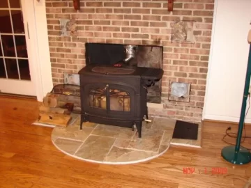

I just finish this. After reading the previous posts I wasn't sure if you meant a wall or a floor. I put 1" Copper Bay flagstones through my 1/2" wood floor (the wood floor was laid over concrete) I went back and forth over whether I should use refractory cement or not or type "S" mortar. In the end, I went with premixed mortar brough in a 5 gallon bucket from home depot, I can lay tile very well, yet I am just slow, the aditives in the mortar allow for a longer set time. I have also tiled wall with the stuff as well and have never had a problem. With 20/20 hindsight I think I made the right choice. I have measured the temp and I think that the rock won't crack or split because of the temperature variations and the mortar won't either as the rock is a good insulator. Anyway the attached photo shows what I ended up with. If you are doing a floor I can either send you more pictures.
Let us know how it turns out
I see you have your wood piled next to the stove - do you have it placed outside your combustible clearances?
Shari

Hello,
Shari, the wood is only there for the photo, I store my wood just outside the back door to the left of the fireplace. I'm sure the wood was there too long I would end up with spontaneous combustion.
Woodracerx, the stone is called Copper-bay, I purchased it from a company called Charles Luck Stone (have a look at the attached link
(broken link removed)) It was very easy to work with and the cost of the stone was just shy of $200. The colors range from a rather light silvery color to a deep copper color.
I hired a table saw the day I cut the stone and I am glad I did. The diamond blade went through the stone like a hot knife through butter.
