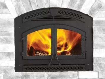

FPX is a good brand. It looks like there are two dealers, one in Virginia Beach (Ray Johnson's Fireplace) and one in Hertford, NC (Tarheel Fireplace). Note however that the overall dimensions of the 44 Elite Wood Fireplace are too large. It has a 49" wide cabinet. The rectangular faced FPX 42 Apex and the arched FPX 36 Elite have a 42" wide cabinet. The Quadrafire 7100 is also arched and fits in a 42" space. There is a Quadrafire dealer in Chesapeake, VA (Magic Sweep Fireplace Shop). They also sell the sister fireplace - the Heat & Go Northstar.
A rectangular faced fireplace goes better with the horizontal stonework, but perhaps a good mason could come up with a way of creating an arch with vertical stones matching the existing? The Northstar photo hints at how this might be done.

Unfortunately FPX will not work in my case due to clearances and such. My hearth would have to be a lot wider and my mantel would have to be a lot taller and farther away from the fireplace. Its funny (no, its not), but I found all of my old notes from when we had the fireplace built. I got a headache just reading them and remembering what a pain in the butt the whole process was because even though the company said they were a fireplace and chimney company, they really didnt know fully what they were doing. Simple things like leaving all the booklets, manuals and instructions built in with the fireplace and no way to access it. (Yeah it had to be torn down and opened back up.) Not building it right so that my hearth didnt fit and I had to go out and buy a new one that would fit. They didnt do the insert right, so when it came time to order the fancy doors, well, because of what they did, we couldnt have that either. And forget about returning calls...... yeah long list of pages with numbers called, the amount of calls that day, etcc.. and it took several weeks to get a return phone call back from the lead guy, and things were going wrong on this end.
So on these other energy efficient fireplaces, I wonder if I would have thte same clearance problems with them? Just checking what all of my options are.

So, back to looking for options on the fireplace......... the FX doesnt work, what else do I have? Oh yeah, I have to take the stones down to get the fireplace out. Sign me confused and frustrated.

We most often replace a unit like yours with a Kozy Z-42. It’s a pretty easy change out usually, with little reframing. The FPX would be a huge undertaking! There’s a lot going on behind the scenes, not a good fit.
