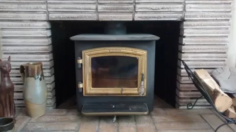

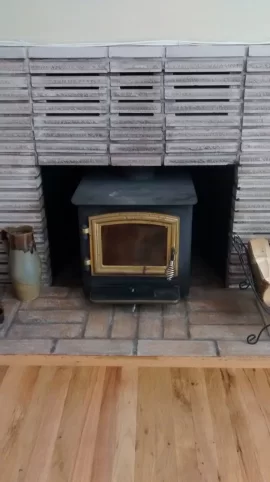

The existing stove is a freestanding one without legs in the fireplace. The hearth is not big enough and we use a hearth pad. We are looking at the Lopi Republic inserts; either the 1750i or the 1250i (both will have the fan option - free manufacturer promo for two more weeks). I keep coming back to the 1250i because I don't want to mess with the hearth pad anymore and don't want to cut or tile over the hardwood floor.

A pic or two of your current setup would be really helpful and the dimensions of the fireplace. Are the Lopis the only inserts you have looked at so far? There are certainly others that may potentially fit your design preferences and other criteria.

I can't imagine preferring an open fireplace to a woodstove, so thank you for reminding me others may think differently. We do have a relatively efficient gas furnace, I just much prefer the feel of wood heat. Attached is our current stove in the fireplace.
We also looked at a Regency insert, but wasn't crazy about the dealership. There didn't seem to be a lot of options locally (especially in the sub $2000 range).
The EPA regulations I looked up indicate that by 2020 emissions will need to be 2.0 grams per hour for new manufacturing. The 1750i is 1.9 and the 1250i is 4.4... just trying to make the smartest choice I can. :-/
