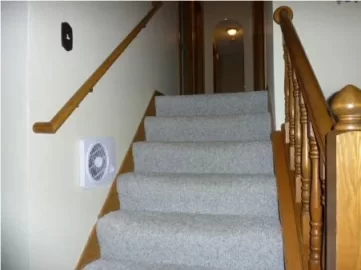

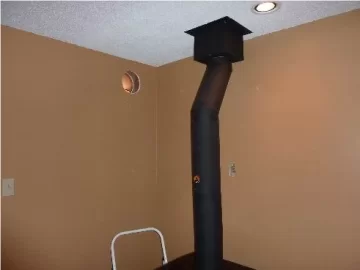

Not to hijack the thread, but I am interested in Minnesota Guy's through wall fans.
Can you elaborate?
Also- do you find pushing warm air into the cold room or does pulling out cold air work better through the wall?
Can you elaborate?
It's only a one-way fan. It pushes a significant amount of warm air into main and upper levels. I can see the thermostat go up or down depending on whether the fan is on or not. I actually have a temporary fan in the hole (happens to fit perfect) for now - still waiting on my deadbeat electrician buddy to help me hook it up.
