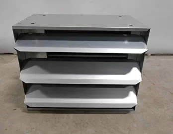

- I plan to use a heating element in the garage ( where the boiler is ) on the main return as a heat dump. either a panel style radiator with a zone valve that sends the return water through the panel if the water gets too hot or a hydronic heater with a fan that is automatically in the loop but the fan kicks on when the temp gets hot. ( either of these would also provide heat in the garage but the hydronic heater with fan could be made to turn on manually if I want to heat the garage etc....) thoughts?
50,000 BTU Hanging Unit Heater - Single Speed Fan w/Thermostat and Air Vent
