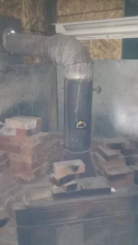

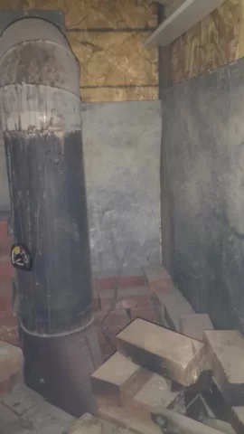

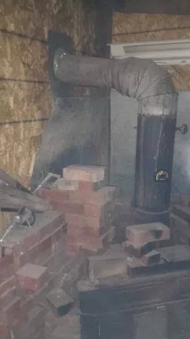

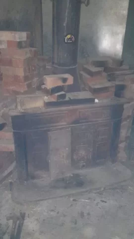

This is how i found it when I cleaned out the shed

First thing im thinking of doing is move it from there and try cleaning it up. Then maybe take the other doors off and fabricating a single door to put on it. Have an old coal bin door that i can fab up for the door.

I think you may want to consider another unit, but also having someone hook it up correctly. I'm not as familiar with clearances as some people on this site, but it looks like a sketchy install. You certainly don't want to burn the building down.

That install is not safe. The hillbilly flue connection is totally bad. What is being used outdoor for a chimney?
Don't use this setup even if you replace the fireplace with a better stove.
Im goig to replace the flue before I do anything. Guess I'll have to use the propane heater until I fix everything. It has regular galvanized pipe outside to what looks like a class A pipe not sure and it has a rain cap on it
I want to run it through the roof instead of through the wall. I can run stove pipe just below where i have the transition to the class A for the roof right?
Also can i run 8" class A from the top of roof and inside run 6" if i change the stove to a new one later on?
