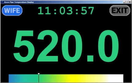

I have a Raspberry Pi that I'm setting up to monitor the temperature with the Auber thermocouple. I know this is old news in this forum, that is, others have done it before. I can check the temperature from any web browser that can access the Pi, and now I'm working on a touch screen display, which is simple and not at all attractive.
Discussion of what colors to use led to me creating a "wife mode" and a "husband mode". Wife mode has blue for cool, green for "good burn zone", turning into yellow when the probe is getting too warm, and white when things are getting out of hand. Husband mode has dark red for cool creosote burn, orange for "good burn zone", then yellow and white just like wife mode. Since I'm using a touch screen, I have provided a touch button to switch between wife and husband mode.
I based the temperature zones on my current bimetallic probe thermometer.
