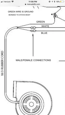

I want to confirm I replaced connections correctly on the distribution wires - white to white and black to blue? They were my first disconnect I got distracted by how tough they were getting apart and forgot to take a good look. It doesn’t say in the wiring diagram.

Power to your blower shouldn’t matter wich wires are connected as long as they are good connections

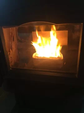

I’m cautiously optimistic ... new circuit board is in. We have a fire. Lit up quite quickly. I cleaned out the distribution blower while I had the stove pulled from the wall. There was quite a bit of dust collecting. I also invested in a quality surge protector. I want to give it a bit more time before I am truly convinced we are good. Time will tell. A big thank you to everyone here who helped me get through this. The holiday season is a horrible time to have so many things go wrong with the house ... you are all very knowledgeable and that is truly appreciated! I hope that someday I can help someone out on these boards.
Ps I am considering a second career as a pellet stove repair person. Ha although it’s not likely to happen I really enjoyed working on it. Just not the stress of it being broken. Must be in my blood since my father repaired aircraft in the Air Force and printing presses after his service.
all finger crossed here...:):):):)
Great , looks good..Cautiously optimistic it is...And on another note, I kind of wonder what happened on the board to cause it to short circuit..
