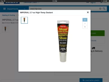

So, I forgot about checking the Lowe's that is a little further away, and sure enough, they have a product that may work out, at least in the short run. It's called Imperial high temperature sealant. Anyone ever seen it? It's rated at 600° F.
I just checked the gasket glue i use is rated to 800f. If that's all you can get I'd give it a try, I bet it works out fine.

What kind of sealant do you use that is rated to 800 F? The Rutland that I see commonly is only rated to 600 F.

View attachment 217759 Thanks for the extra push. None of my local stores had any kind of high temperature sealant that I could find online. Maybe I missed something.

I use imperial brand like you linked. But the stuff specifically for gaskets. When eventually you get a new PE gasket it will have adhesive on it. You peel a backing off like a sticker and just stick it on your cleaned up door groove. Clean it well and thoroughly for it to stick well.
Red RTV will also work. Some new stoves are coming with black RTV too.
Anything behind the gasket will be shielded from burning, anything oozing out from behind the gasket will burn off. You don't need 800 or 1000 degree silicone to get the job done. You're merely paying more to do the same job.

I ended up going to Lowe's and getting the Imperial stuff, that is rated at temporary highs of 600°F
