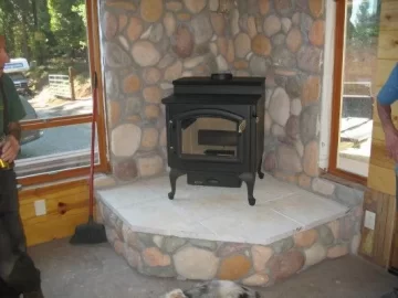

Well if you have the stuff use it, I had to have an R factor so I used the cement board and it worked just fine. Heres a pic
Thats a GREAT looking install.
Is that real rock or manufactured stone (concrete)
I want to do something with flagstone and still need a 1" space behind the concrete board.
Can that stuff be installed over concrete board that is attached to the wall with spacers?
I built a hearthpad and hung concrete board to reduce clearances and would like to be able to keep the clearances and have something other than painted durock behind the stove.
Thanks, Its Owens Corning cultured stone and tiles. The hearth is 11/2" tile on 2- 1/2" layers of cement board on metal studs on another layer of cement board over 3/4" plywood on wood studs. Walls are the cultured stone 21/2" thick on 1/2" cement board and metal diamond lathe on 2x6 studs. For clearance on the Quad I only needed 2" at the corners so spacer panel was not needed.
