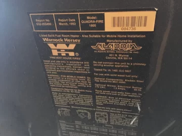

The seller found the nameplate. Looks like a really old quadra fire. Their website doesn't even have the manual anymore. Oh well - the search continues. Thanks for the help.

Yes, I thought this was an old dogger. There is no side air control. It is their first EPA model, back when Alladin made Quadrafires. They were bought out by HHT. It is a pedestal stove missing the base. There was an 1800-i insert version, but it has a bay window front with side glass.
The manual is online if you are interested:
