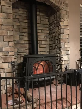

My home is 2000sq' with a 20x30 living room with 12' vaulted ceilings. The F500 is in the corner. I haven't had a problem with the room getting to hot...although it would be easy to do on some days when only a small fire is needed to take the chill off. The rest of the house stays about 68-72 degrees as long as I am keeping wood in the stove on colder days.
