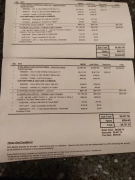

3. I have attached two quotes, one for the smaller version and one for the larger version. I mentioned (based on my reading of other posts), that it may be better to put in a insulated liner and I was told no. They block the top of the insert with insulation (some kind of damper wall) and also block off the top with a cap and I don’t need or want a insulated liner since it will go through my chimney. What is your opinion?
OK, so my preference would be the larger insert only because it has a nicer look and a bigger viewing window. The shop tells me I can use the larger insert and just not burn at it’s highest levels. Does this sound right?

Thanks again. View attachment 229509
