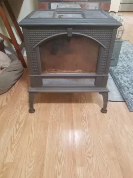

Once again, I appreciate everyone's help. I decided I wanted to go with a Woodstock based upon the reviews, and that I actually like the idea of going directly to the manufacturer for my needs. I really don't like dealing with dealers for anything. But anyway, I decided Woodstock was the way I was going to go. I found a Keystone "locally" that I thought was priced well. It needs some cleaning up, but it fits our living space real nice. I know with this I lose the long burn times I was hoping for, but in reality we are around the house enough to keep it loaded up and going. I also thought, for the price, this would be a good way to find out what our heating needs are and what our expectations will be in the dead of winter. So, hopefully this little Keystone will give me a better idea of what I may need, or hopefully, I may find out it is all I need. Thanks for all the help, I really enjoy this site and am learning alot!

The Keystone is a great stove and one of the best looking of their soapstone models IMO. It will have a decent burn time, especially in mild weather when the stove is not being pushed hard for heat. Go through the stove components (bypass, combuster, gaskets, etc. and make sure all is in good working order. There is a small oddity in that it requires a 7" flue. What will the stove be connecting to, a preexisting chimney or a complete new flue system?

The stove will be connecting to an existing chimney, 6" flue. I saw on Woodstock's site that it is acceptable to reduce it to 6". Thanks for the heads up on what to be looking at and going over. I really like the looks of the Keystone myself.
The Keystone is a great stove and one of the best looking of their soapstone models IMO. It will have a decent burn time, especially in mild weather when the stove is not being pushed hard for heat. Go through the stove components (bypass, combuster, gaskets, etcTheir is a small oddity in that it requires a 7" flue.
They need to put that in the manual which in some cases is all that an inspector or insurance company will go by. Maybe email them for verification so that you have it in writing from their tech support staff.
The keystone is a great looking stove, all cat, long track record, and I've never read of an unhappy owner. This is one of the stoves that "made" woodstock.
