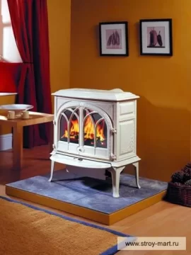

Recently I purchased a home that has a Consolidated Dutchwest stove. Post Insurance company inspection I was told that my stove does not have enough clearance and I will be dropped from my insurance if I don't fix the issue. I'm debating between unhooking until I have the funds to fix the issue or fix the issue and bite the bullet. Ofcourse after strangling my incompetent home inspector and hopefully sticking him with the bill. Never the less, my parents have always had wood burning stoves. My parents have a Jotul Top loader stove with a pedal that opens the top. Does anyone know the model of the unit I speak of. Doesn't look like Jotul makes them anymore but I would love to locate one.
Jotul - F400CB Castine
This picture looks similar to the stove I am speaking of only it is black. If anyone has any information or where I might find one I would be very happy. Lets get rid of the Dutchwest. I'd consider a trade.

That is the old style Castine Mark. Where do you live? Maybe Carpneil still has his for sale?

The Jotul Firelight was their largest stove: top loading with the pedal mechanism and catalytic. The non-cats replaced all Jotul models sometime in the 1990's. It was a competitor to the largest real ;-P Vermont Castings' Defiant in heating capacity and top loading.
Those cat Firelights are still in use; you may find one on the used market. Reports from users were that it was built like a tank, but the pedal mechanism was clunky. Good idea for loading with an armful of wood. What happened ?
I have that Jotul. Firelight Model 12 Cat, made in 1996, top loader with the foot pedal. I guess they couldn't get the top loading to work with the burn tubes when they went non-cat, the new ones are front and side loading (they still have a fake top loading door cast into the top of the stove - but it doesn't open)
