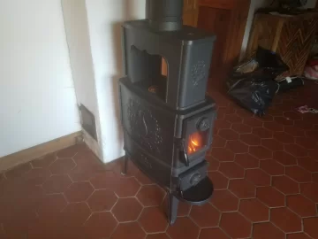

You could check out something like our Morso 2b Classic. It's only rated to 1,200 sqft. We use ours to heat our whole 1,200 sqft salt box. Jotul makes two long narrow stoves as well.
I think our morso has 26" side clearances, but you could reduce that with the proper shielding on the cabinets.
