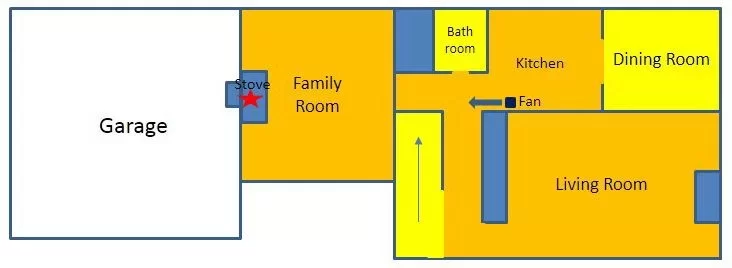

My stove is not in an optimal location. I keep the stove room at about 80 degrees F, the rest of the first floor stays at 70-73 degrees, and the upstairs rooms are cooler, about 65-68 depending on sunlight, etc. I use a little bit of electric baseboard heat to supplement the upstairs.
Thank you for the diagram. Do you have any result in the dining room thanks to the fan?
And last question... your honeywell fan... maybe I could put it on a tall piece of furniture pointing it toward the ceiling, so that the cold air will be forced up and the hot one forced down as they will be forced to mix up themselves?
Yes, the dining room and living room are about 70 degrees F. The kitchen is usually 72-73. I've had very good results just blowing the cool air straight across the floor to the stove room. I think blowing the cold air upward would likely block the flow of the warm air across the ceilings, so no I have not tried that. The heat just pours out of the stove room throughout the rest of the first floor, and does quite well upstairs too. I have a second fan in approximately the same location upstairs, blowing cool air down the hallway toward the stairs. On the diagram, the stairs are represented by the long thin blue arrow that points up.
