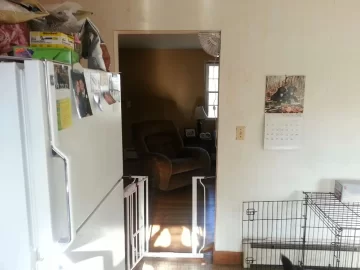

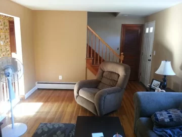

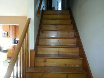

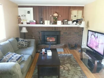

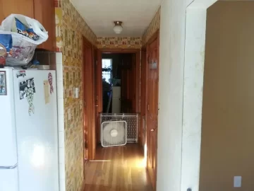

Second year burning and Im trying very hard to heat this drafty cape house with wood only. I filled the oil tank last week and don't want to use it unless I absolutely have to. Attached are some pictures of the rooms I am trying to heat. Please disregard how horribly messy the house is. It's just my wife, the dog and I. Attached are some pictures of the room that the stove is in as well as the layout of the first floor. The second floor isn't an issue as alot of the heat goes right up the stairs to the second floor and heats the upstairs just fine. I have very poor insulation in the attic and second floor and I understand that I need to fix this but I'm just wondering if I can do anything else to move air around. Notice that i have a fan in the small doorway in the living room (where the stove it) pushing warm air down the hallway and a doorway fan blowing it into the kitchen. I also have a small box fan pushing cooler air into the area of the stove but can't send it directly to the stove itself due to the small doorway. Thanks for any tips or info you can give me.

Yes, move the cold air. Cold air is more dense than warm air (hence stratification). Could you actually post up a floor plan?
Edit: I also notice that you have one pedestal fan. It works best if you keep all fans at floor level to create a thermal loop. The pedestal will "mix" the air and make this more difficult.

Get you a small low to the floor fan set it up at the top of the stairs blowing down to the heated room.
Its will take the cool air off your floors upstairs and move it down towards the room with the stove. This allows the hot air to move upstairs traveling along the ceiling of the stair well.
Tape you a piece of toilet paper at the top of the stairs at the top of the door way up there and see how it moves when you turn on the low to the floor fan facing down towards the room below. The fan need to be on the floor and move the cooler air off the floor to the room below.

I guess I wasn't as clear as I thought in the original post... I have no problem getting the warmth upstairs... if I stand at the bottom of the stairs with no fans running I can actually feel the cool air rushing down the stairs towards the stove. The pedestal fan is set up as high as possible pushing air down the hallway. The small box fan that is on the floor at the end of the hallway is pushing air (cool as it is on the floor) towards the stove room. My intention this spring is to almost tear down the wall that seperates the living room and kitchen/dining area. I'm sure this will open things up a bit to help move the air around better.
That tall fan is still "mixing" the air. Not a bad thing in some situations, but for creating a convection loop, it is easier if the air is stratified, cold on the floor, warm at the ceiling)

The strip of TP at the top of the doorway really helps. I have found that moving my hall fan less than two feet closer or farther back makes a huge difference in the amount of air moving down the hall. Tape some TP up and start experimenting with fan placement. The gate in the hall was a problem for me also.

Fans at that other end of the hall way I think you said your blowing the cool air towards the hot room but I think you need a small fan that will sit low to the floor to create that separation of moving cold air along the floor towards the hot room and getting warm air moving back along the ceilings. That 9" fan I posted the pic those work extremely well for this type of situation. They will move alot of air at a low, very quiet setting. They are small and sit low to the ground and will not block your door ways like the big box fans do.

I got a kick out of the butane torch on the mantel. :p
