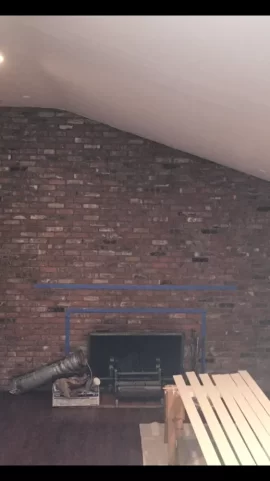

This may take some undoing of part of the new wall. Do you have a before picture? A picture of the framing before the drywall went up?
I don’t. Here is a photo before the wall was built. The 2x4 is that runs across the top of the fireplace is 15 inches above the lip of the fireplace opening.

Here is the before photo.
That wall is huge, and imo is rather imposing to the size of your mantle. It might be more impressive if you enlarge the scale of the mantle to balance the wall, keeping the mantle at safe clearances from the fireplace, then parge and paint that masonry wall to match the mantle.
Thanks, that's helpful. Can you return the mantel? I agree that a larger mantel would look better given the scale of the wall. And it looks like it will be needed to honor clearances.

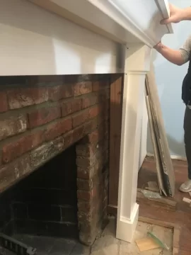

One option is to cut back the sheetrock and reframe the opening at the proper clearance dimension.Then install the new larger mantel with a facia board covering the built out framing.
It's a shame that the wall was built out with 2x4s, that was not necessary just to cover the brick with sheetrock. The sheetrock could have been put right over the brick. But now that is what you have. With a new mantel one option would be to have the mantel properly sized for clearances from the fireplace opening, then cut out existing drywall around the fireplace and reframe so that the new mantel sits against the brick with the sheetrock coming right up against it.
3" block in front with your tile on that. Cant have any gap at lintel. Assuming you have bearing for it on hearth. Assuming the rest is compliant of course.

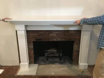

By looking at it it seems you would have enough space to build out the face and have proper clearances.
You are going to need to extend that mantel, though, or its decorative leg mouldings will be nowhere near it. Maybe just screw a longer 1x10 to the top of the 1x8. You could extend the legs with plinth blocks bottom and top (and in the middle if needed). (Or return it and get a bigger one.)
