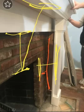

The sample you posted has mosaic tile on it. Is that your objective? If you lay a 3" block face in front of the brick and apply tile to that with thinset, would that accomplish what you desire? You would need a lintel to carry the block over the opening. Of course there can be no gap above the opening. You would need to lay it tight and apply mortar where the block is against the brick. You could only do this if the hearth extension is built correctly underneath in order to carry the load of the block. Do you follow?
I follow. That’s a great idea. Thank you.
That would get it done. Is it to code would be something you would need to verify. Along with the existing chimney construction as @bholler said. I cant say.
So far, besides 1 or 2 responses it seems like people are more interested in failure than solutions. IMO a solution would be to have an insert installed to be flush with the new wall or build brick out to be flush with the new wall. All the responses have just reafirmd the problem with no solution.
I disagree. No one here is interested in your failure. Twenty one posts later you add an "insert" into the conversation.
In the gentlest of tone, I will not give you the green light and assume liability for the all the unknowns. Without the additional knowledge of an insert, your mod and solution, at first glance, was not presumed safe AND, now that we know you intend to install an insert I suggest you consult a professional and apply for a permit, if required, so you know you have met the minimum clearances to combustibles and with that we all can sleep safe at night.

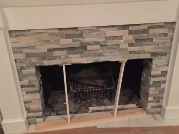

Finally finished the first part of my project. What you think?

Wow...! Big change. That looks marvelous!
Please forgive me for my trivial curiosity. From the point where your insert will be installed, does your stove/fireplace meet the minimum clearances to combustibles?

Much betterer.
Nicely done. Will this be used just as an open fireplace or will an insert be going in now?

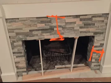

We decided to stick with an open fireplace and not go with an insert after speaking with the local fireplace store. We laid cement board and concrete to build out the wall, didn’t use block. In terms of the height and width the local fireplace store said code is 12 inches and we are 14 inches and six inches on each side and we are just at 6 inches.
Sounds good. It looks like you still could put in an insert if you later change your mind. The clearances are from the insert body.
I don’t know a ton about inserts...is there a big benefit? Also how would they get the insert flush with the rough rock? Also- that’s actual stone not cultured stone so each piece is different in depth. 1-1.5 inches.
