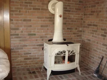

I refuse to puff up my chest and tell you what I own is the best! What I will say is although the V.C. brand has been under scrutiny lately they (the factory) and the stove have performed better than expected after I went through the learning curve.
This Defiant CAT has a large fire box, looks great and has 10++ real life burn times. This stove works for me because I need hot stove temps since it's in the basement and vented upstairs with a ceiling cut out. I use a small fan to assist the air flow and keep the basement temps lower.
Good luck and enjoy your new home!
