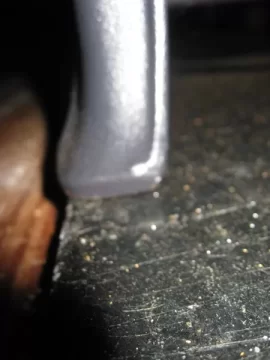

I know this sounds crazy, but our new Jotul Oslo which weighs in at 450 or so pounds moves around on our hearth. The hearth is extremely smooth. Not sure what kind of stone but am attaching picture. In photo you can see leg sticking over edge of hearth slightly. Dealer sent 2 guys to cut pipe and move it back. Since then, I have noticed the right front leg creeping gradually towards the front of hearth. Now I do have 2 girls who like to run and jump alot in the living room. I think it may be that vibration which is causing it to move? It was a simple matter for me to push it back into place, but I don't want to have to do this all the time, and I can only really do that when the stove is cool, and I plan on running this baby alot. Any suggestions on how to make it stay in place? I was thinking maybe epoxy 2 smallish metal plates to the hearth in front of the legs, using some kind of non combustible glue or whatever. Thanks for any ideas.

It was a dealer install? Call them back. They should set you up with a hearth your stove doesn't slip around on. It shouldn't be a "simple matter" for you to push it back into place (you're moving over 400lbs of iron)...so the hearth is too slick. If that is a pic of a front leg, you should have space in front of the stove (16"? 18"?) for ember protection anyway. With the side load door, you want it on the sides of the stove too - check your manual to see what you need.

That picture was taken before the dealer cut the pipe and moved the stove back. They installed the stove on the existing hearth which was in front of an old heatilator fireplace. Maybe I could slide some tiles under the legs to provide more friction?We do have an 18 by 48 inch mat for ember protection that lies in front of the stove. We may replace that with something more substantial, but according to the manual that is all we need. I dont plan on using the front door much if at all so I am not really concerned about embers and logs rolling out the front.
