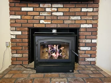

If you have metal fab skills and some extra time, you could even do like I did and make a trim kit out of metal panels that goes behind the insert and paint it with stove paint for a nice finished look. I have an Osburn 3500 insert with a 3 cu ft firebox, but if you don't need/want that big of a stove, Osburn and many other manufacturers make inserts of various sizes that could work. Here's the trim kit I made to go behind my insert:
[Hearth.com] Help choosing insert/stove for fireplace
Here's what it looks like installed:
You can still see the shiny stainless stove top adapter that connects it to the liner, but that doesn't bother me.
