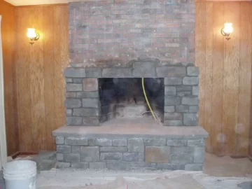

I just finished installing cultured stone on my fireplace last week. It's a nice change after staring at the cement board for 8 months!

Rocketman, your fireplace looks fantastic. The stone appearance is what I had in mind. I am looking at something called cobblestone. Do I need backerboard attached to the brick or can I just cement the stone directly on to the brick?
I will be knocking off all the bricks that stick out and making it as flat as possible.

Wire mesh can be attached/fixed directly to the brick, and cultured stone applied to the mesh.
