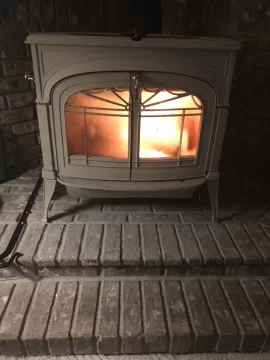

This what it looks like with cat engaged air turned all the way down griddle temp is 500 only a couple pieces of wood in it
I’ll check that out is there anyway maybe the doors could be leaking? If so would stepping up the size of gasket material make a difference?
No, stick with factory size gasket. Have you done a dollar bill test on all the doors?
Agreed, that flame looks way too active on low. It sounds like you replaced all of the gaskets in the stove. You may be able to find an air leak by using a piece of incense and wave it around any joints to see if the smoke gets sucked in. You can do the same with a lighter too I would think, see if it pulls the flame in. Your stove sounds like it runs exactly like my old Encore would before I replaced all the gaskets and made sure it was sealed up.

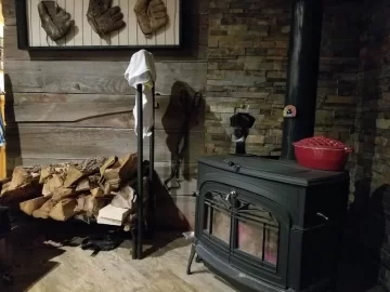

definitely a leak somewhere... not the best picture, but this is on almost shut down.

If I turn the air down all the way...the flames are gone on 5 minutes and the stove goes black almost except for glowing coals at the bottom. Of the cat is active I can see it glow in the back. Flames like that shut all the way down really make me think as well as previous posters you have air leaking into the Firefox.
I took a lighter and ran the flame around the doors and around the bottoms of both doors it sucked the flame into it is there an adjustment for that or just have to replace them the gasket were brand new three months ago? That’s the only place it would suck the flame in.
So I did the paper test on the gaskets and the top is great but between the doors and the whole bottom of both doors and the far right side and far left side the paper pulls out super easy the bottom gasket isn’t even touching the stove on either door? Is it possible to bring the bottom of the doors in?
