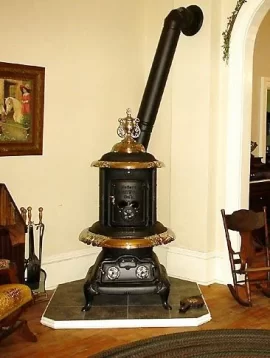

We are installing a Harmon XXV freestanding stove with the top vent option.

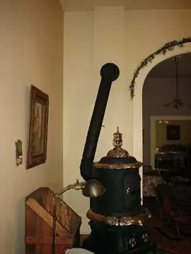

One of my concerns is that it is a tall chimney. Our home is 140 years old and has 12 foot ceilings so that means the chimney is quite tall. Currently we have a 1907 Modern Glenwood Round Oak wood burning parlor stove installed at this location. My husband uses a 7" cleaning brush to clean the chimney and there is a cleanout door at the bottom of the chimney on the other side of the wall. The chimney comes down an inside wall between our sitting room and the formal living room. There is also a hole on the other side of the chimney so that a stove could be placed on that side of the chimney as well.
I will see if I can post a picture. These pictures were taken when the protective heat shield that we use around the stove was removed for the summer. But it gives you some idea of the height of the ceilings inside the house.

In this install you could just connect to the Clay flue as long as you get a good seal and there is no cracks in the flue tile.
