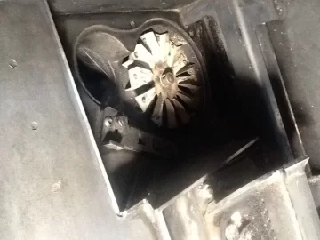

I took out the allen set screw but fan blade doesn't slide off? Anyone know the trick?

Success...its off. Did a search of the website which I should have done first! Usually the problem starts with the set screw but mine came right out. The fan was frozen on the shaft so sprayed some WD-40, tapped it with a big screw driver and off she came. Only two seasons of burn but she was nasty underneath. Blower fans behind unit were fine, just vacuumed, put some duct tape over the chimney inlet and closed it up. Put duck tape on my cord plug as a reminder. Wire brushed all the removable panels, will spray with PAM and add some Damp Rid.

I spray my blades and shaft with "Dry Moly" and remove it once a year, then after cleaning behind the blades, I spray that area with dry moly also.
If you want to get fancy, you can also clean the area behind the blades with Acetone and wire wheel any rust off, then spray with high temp stove bright Satin Black stove paint or Ultra High Temp Flame Proof Flat Black 2,000 Deg spray paint from the auto store used for headers. :-)
WD-40 works and sometimes PB Blaster works a little better.

Why not Scott? As many Harman owners know when it comes time to take that fan off to replace the combustion motor, it can be a bear of a job with the end result having to use a cutoff wheel and cut the shaft. It would seem prudent to remove it every couple of years so it will come off when you want it to....

I take mine off every year so it will not get frozen. Also it is much easier to clean behind there with the blade off. Then I can easily upgrade to the new double paddle blade that has each petal riveted. :)

And i pull my fan 2-3 times a year, reinstall includes a dab of antiseize on both the screw and shaft. No problems with fan sliding right off but it might be the frequency rather than the antiseize.

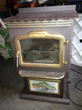

Gotta have those upgrades.
When ya pick up a stove like this it needs a few upgrades!!!
Golden-fire brown with tarnished gold trim!!!
Except I kept the cast iron fine box cover! :)
