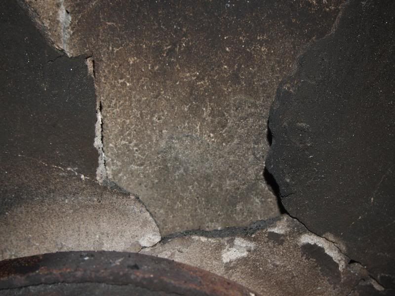

Hi guys,
Im a single girl in the middle of doing up an old house and the fireplace was used up until I took over the house but on inspecting it I really don't think it should have been used, there is severe cracking in the concrete on all three sides of the fire place, What should I use on it to seal it, any advise gratefully (pardon the pun) received, as im on a strict budget and doing all the diy myself, I have been told to remove the loose render and use the no nonsense fire cement, do you think that will do the job,

Welcome to the forum Jenny.
I hate to say it but there is no way I'd burn in that. Perhaps some others will make some better suggestions and if so, I'll leave it to them. In the meantime, you also need to check the full length of the chimney to make sure that part is okay. Many times we find they are not and you don't want any house fire for sure.

Thanks hun, this is why I thought I would come on here and ask for some advice, I cant believe previous occupants used it, ( it still had wood in it when we took over) I do have a chimney sweep coming during the week, but how do I find out about the rest of the chimney, im new to this im afraid and wouldn't even know who to ask,
Jenny, the sweep will be able to check that. He can also look at the fireplace. It is good you have called him.

The sweep should be able to tell you if the chimney is safe and what work it might need.

The chimney sweep is your friend. Have him inspect the entire system from the fireplace to daylight and give you some professional assessment & recommendations. This is not a simple project. What's your eventual plan for this fireplace? Keep in touch with us here, and welcome to the forums! Rick

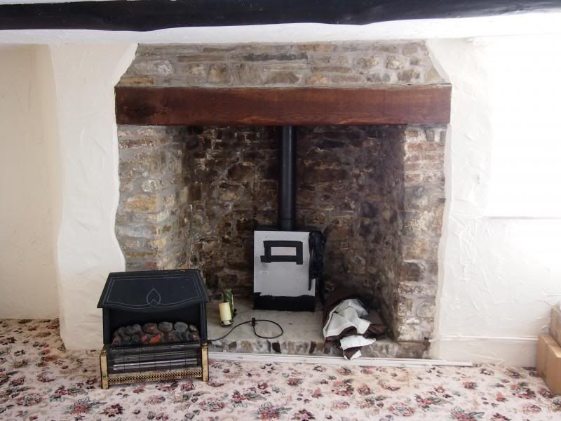

Thanks cynnergy, and yes I am very lucky living in devon, its all thatched cottages and open fields but will be much nicer when I get this fire sorted, I have 5 of them to sort out (1 in each lounge, 1 in the dining room, and one in the bedroom ) The one in the drawing room is huge you can stand up in it, but previous people took the burner and there is just a tube hanging from the inside of the chimney so not sure what I will do with that yet,

like Rdust said, a qualified sweep will know what he is looking at, one look at that fireplace and he's going to tell you straight on, no burning not a matchstick. but i true pro will check the entire system and tell you what the options are.
this may be good!, if the flue system is ok there a stove may be possible which could heat a generous area. shoot a pic of this one and lets see what we have to work with
just had the chimney sweep out and he has inspected the chimney and its got a clean bill of health, s with regards to the cracking lining at the bottom, the house is solid and there is no wood or any other accelerators in the lum, so he has removed all the cracked lining and said its safe to use, but does advice having it reskimmed at one point and he will come and do it in January when he comes to re sweep the chimney. so im going to light it tonight and enjoy our first open fire. Now to decide on what wood is best

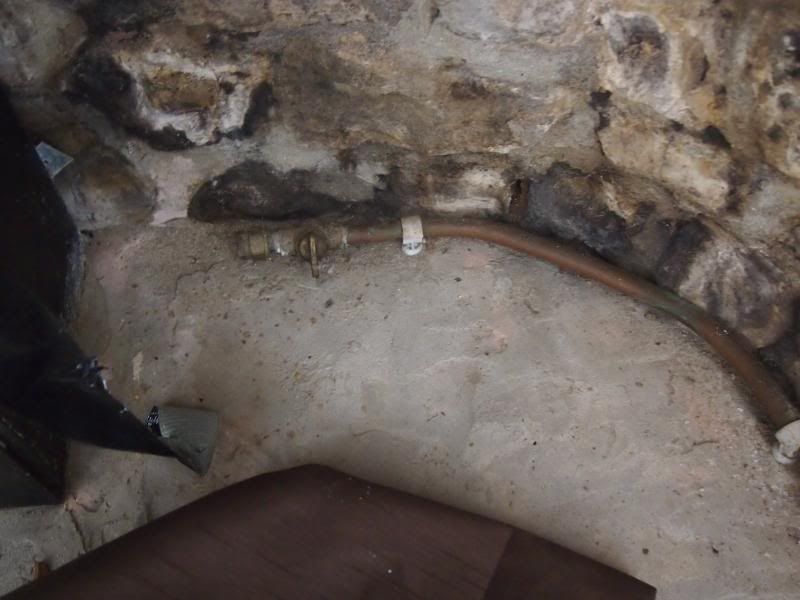

he also had a look at the other large fireplace but this has been lined and we noticed a gas pipe, so looks like that chimney is redundant,

and as for the huge fireplace in what was the old kitchen, ive decided to keep it shut as its such a huge thing. (plus my wine rack looks pretty snazzy in it lol)
