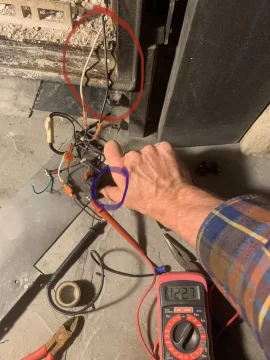

Thank you for the quick reply. If you look at the picture, you can see the red circle is my thermodisc bypass and the purple circle is my thumb pressing the button - the leads on the multimeter are connected to the neutral and the hot that has gone through the various ‘checks’. My output on the multimeter at this point is how it should be. The moment I attack wires from one of the two blowers - the reading on the multimeter goes to zero.
